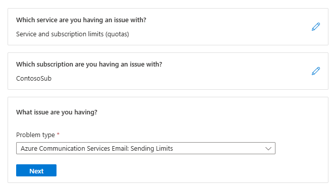

Select your subscription, click Next. For Problem type, scroll down to bottom and select Azure Communication Services Email: Sending Limits, then click Next

5. Select Issue type: Service and subscription limits (quotas), Subscription: <subscription that needs quota increase>, Quota type: Azure Communication Services Email: Sending Limits, click Next
support request Problem description tab
