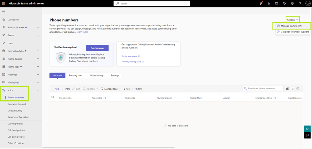

    • Sign in to the Teams Admin Center, then go to Voice > Phone numbers and select Manage porting PIN to create a 10-digit numeric PIN. This is the PIN your new carrier will use to authorize the transfer request.
    • User's image
