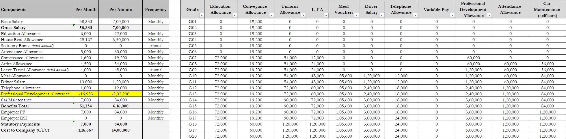

Hello Group,
I am currently building a grade-based salary calculator in Excel and could use some help with the formula logic.
I have a total Cost to Company (CTC) cell, along with fixed components like Basic Salary, HRA, and Statutory Contributions. The remaining CTC is distributed across various allowances (Education, Conveyance, Attire, Driver Salary, etc.). Each allowance has a maximum cap determined by the employee's Grade via a lookup grid on the right side of the sheet.
I have designated Professional Development Allowance (PDA) as the final balancing component to absorb whatever is left of the CTC. PDA = CTC - Statutory Payments - all components At lower CTC levels or for certain grades, the sum of the standard allowance caps plus Basic/Statutory exceeds the total CTC.
This causes my balancing component (PDA) to result in a -ve value, which shouldn't happen. Instead of PDA going negative, I want the other allowances to automatically scale down or drop to zero based on a strict priority order so that PDA never drops below 0.
The priority of allowances is as below:
  • Attendance Allowance - Driver Salary - Attire Allowance - Car Maintenance
Hope I did not confuse with the extended query. I have made the sheet using circular reference. if there is any better approach, would be amazing. Thanking in advance.

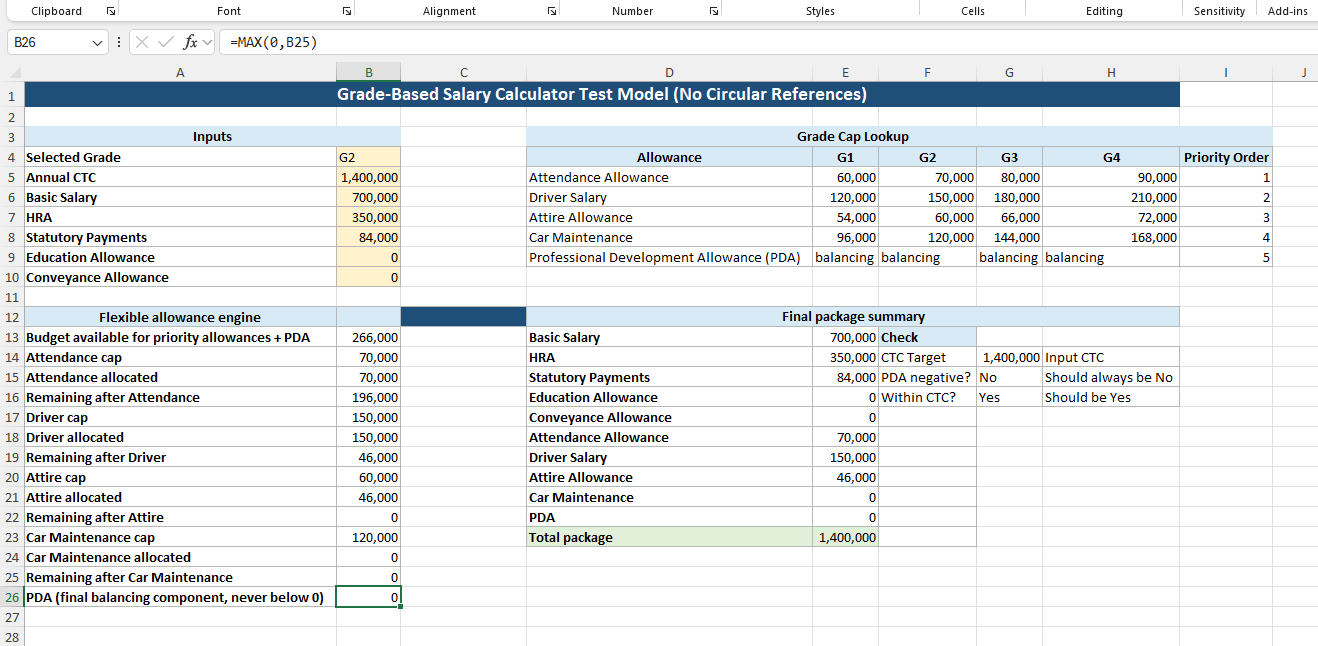

  1. Liora D 15,970 Reputation points Microsoft External Staff Moderator
    2026-06-04T11:16:42.9166667+00:00
    Dear @Pratap Reddy,
    I hope you’re having a good day.
    Thank you for explaining the scenario so clearly, the issue itself is not really the Excel formula, but the allocation logic behind it. From your screenshot and description, the negative value in PDA happens because the other components are being assigned first, and in some cases their combined value already exceeds the available CTC before PDA is calculated.
    A cleaner approach here would be to avoid circular references entirely and use a one-way allocation flow instead. In other words, after calculating your fixed components first, you allocate the remaining budget step by step across the allowances in your chosen priority order and let PDA take only the final remainder. This way, PDA can never go negative.
    The logic would look like this:
    Calculate the flexible budget available after fixed components:
    =MAX(0, CTC - Basic - HRA - Statutory - Education - Conveyance)
    Lookup each allowance cap by Grade.
    Allocate in strict priority order:
    Attendance = MIN(AttendanceCap, MAX(0, FlexibleBudget))
    Remaining1 = MAX(0, FlexibleBudget - Attendance)
    Driver = MIN(DriverCap, MAX(0, Remaining1))
    Remaining2 = MAX(0, Remaining1 - Driver)
    Attire = MIN(AttireCap, MAX(0, Remaining2))
    Remaining3 = MAX(0, Remaining2 - Attire)
    CarMaintenance = MIN(CarCap, MAX(0, Remaining3))
    Remaining4 = MAX(0, Remaining3 - CarMaintenance)
    PDA = MAX(0, Remaining4)
    This ensures that each allowance only consumes what is still available at that point, so the lower-priority components automatically reduce or drop to zero if the CTC is insufficient. PDA then becomes a true balancing component rather than a negative residual.
    So, in short:
    you do not need circular references for this
    you should calculate allowances sequentially from the remaining budget
    and PDA should simply be the final non-negative remainder
    I believe this will be much more stable and easier to maintain than an iterative circular-reference model. If helpful, you could also keep a final validation line such as:
    =IF(PDA<0,"Error","OK")
    to quickly verify that the model is behaving as expected.

    Use a non‑circular, “top‑down” formula pattern that caps each allowance at its grade limit and at the remaining CTC, and then lets PDA be the leftover. The key is to compute each component in strict priority order, always using the remaining CTC as an upper bound, and finally set PDA to MAX(remaining,0) so it never goes negative.
    Assume these helper cells (adapt to the layout):
    • CTC in cell B2
    • Total fixed/statutory (Basic + HRA + statutory contributions, etc.) in B3
    • Grade‑based maximum caps (from lookup grid) already calculated for each allowance in separate cells, for example:
      • Attendance Allowance cap in C2
      • Driver Salary cap in D2
      • Attire Allowance cap in E2
      • Car Maintenance cap in F2
      • Any other allowances with higher priority than PDA in other cells
    1. Remaining after fixed components
    In a helper cell (or directly in the first allowance formula), compute:
    =B2 - B3
    Call this Remaining1 (conceptually). In formulas below, this is recomputed as CTC - fixed - previous allowances.
    1. Attendance Allowance (highest priority)
    =MAX(0, MIN(C2, B2 - B3))
    • B2 - B3 is CTC minus fixed components.
    • MIN(C2, B2 - B3) ensures Attendance never exceeds its cap or the remaining CTC.
    • MAX(0, …) prevents negative values if CTC is already less than fixed.
    1. Driver Salary
    =MAX(0, MIN(D2, B2 - B3 - Attendance))
    Replace Attendance with the cell that holds the Attendance Allowance formula. This caps Driver Salary at its own limit and at the remaining CTC after fixed + Attendance.
    1. Attire Allowance
    =MAX(0, MIN(E2, B2 - B3 - Attendance - Driver))
    1. Car Maintenance
    =MAX(0, MIN(F2, B2 - B3 - Attendance - Driver - Attire))
    1. PDA as balancing component (no circular reference)
    Finally, PDA is simply what is left, but never negative:
    =MAX(0, B2 - B3 - Attendance - Driver - Attire - CarMaintenance - OtherAllowances)
    • Include all other allowances that must be paid before PDA in the subtraction.
    • If the sum of fixed + capped allowances exceeds CTC, this formula returns 0 instead of a negative PDA.
    1. Optional: combine logic in one cell using LET
    To avoid repeated expressions and make the formula easier to maintain, use LET (Excel 365):
    =LET(
      ctc, B2,
      fixed, B3,
      capAtt, C2,
      capDrv, D2,
      capAttire, E2,
      capCar, F2,
      rem1, ctc - fixed,
      att, MAX(0, MIN(capAtt, rem1)),
      rem2, rem1 - att,
      drv, MAX(0, MIN(capDrv, rem2)),
      rem3, rem2 - drv,
      attire, MAX(0, MIN(capAttire, rem3)),
      rem4, rem3 - attire,
      car, MAX(0, MIN(capCar, rem4)),
      rem5, rem4 - car,
      pda, MAX(0, rem5),
      pda
    The same pattern can be extended to all allowances in the required priority order. This removes the need for circular references and guarantees PDA never becomes negative; instead, lower‑priority allowances automatically scale down to zero as CTC or grade caps constrain the total.
