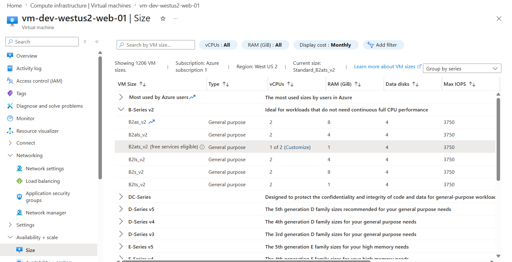

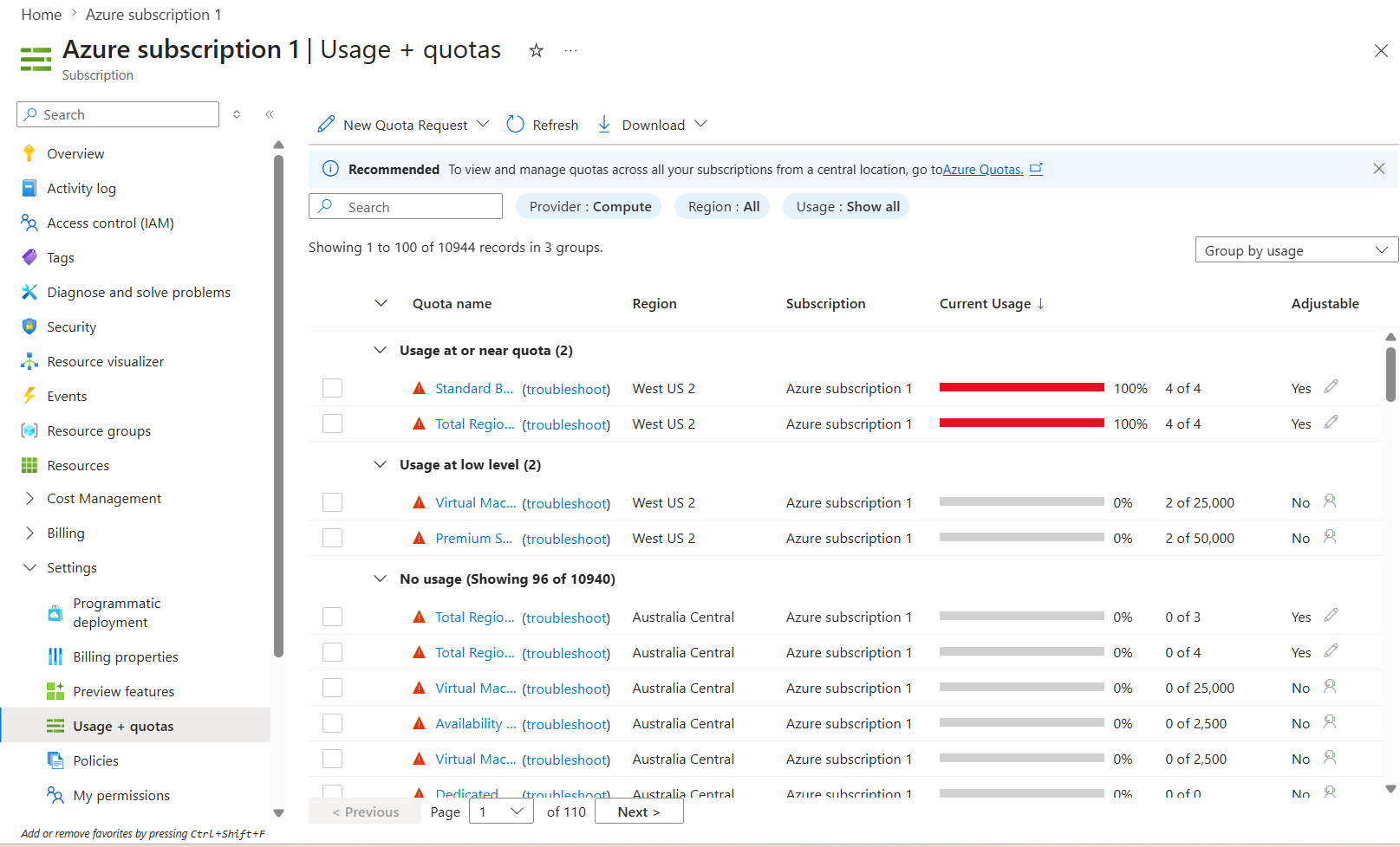

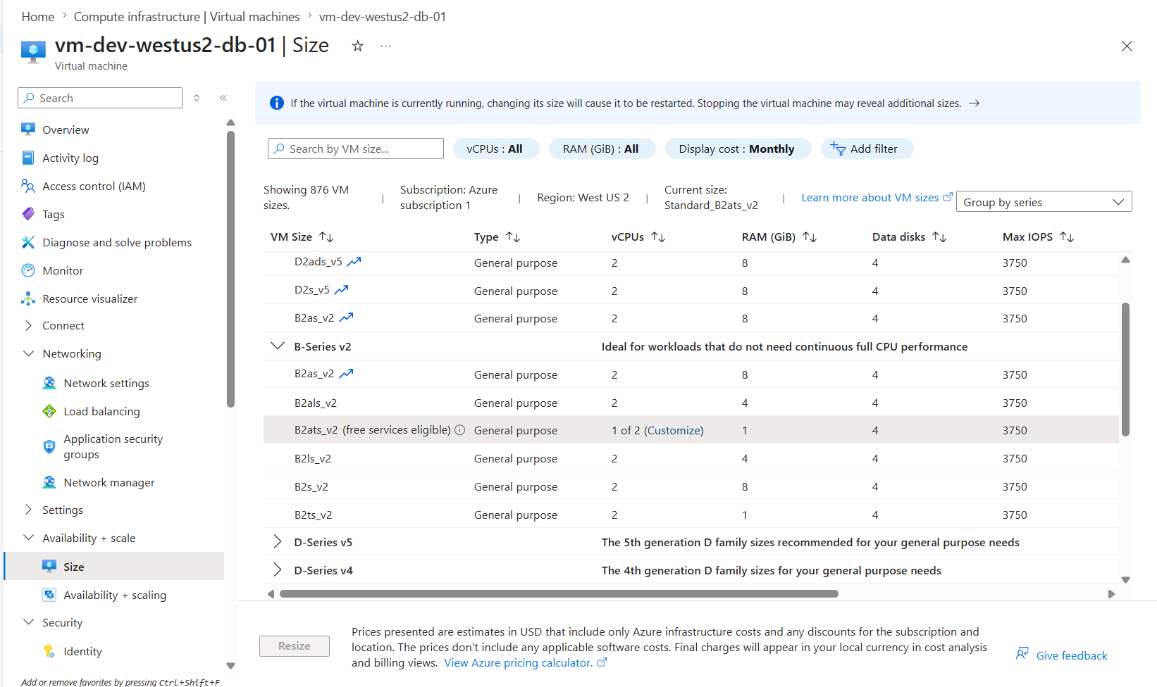

Hello. good evening. I am currently using the free tier of Azure. I have two virtual networks in West US 2 and have reached the quota limit. However, I need to create at least two more virtual machines in this region. I resized the virtual machines but it did not help. Could you help increase the overall vCPU quota or the specific series quota in West US 2?"
(Please find the attached images for the problem)

    From the screenshots, I can say that the issue is not the VM size page itself. Your West US 2 Compute quota is already fully used. Look at Standard B-series vCPUs: 4 of 4 and Total Regional vCPUs: 4 of 4
    Azure VM quota is checked at 2 levels: the Total Regional vCPU quota and the VM-family quota such as B-series. A new VM can be created only if both quotas have enough available vCPUs.
    https://learn.microsoft.com/en-us/azure/virtual-machines/quotas
    Resizing existing VMs will not help unless the resize actually reduces the number of allocated vCPUs. Also, Azure quota counts vCPUs used by both allocated and deallocated VMs, so simply stopping a VM does not free quota and you would need to delete unused VMs or reduce their vCPU size.
    To create two more VMs in West US 2, request an increase for Total Regional vCPUs in West US 2 and Standard B-series vCPUs in West US 2
    You also mentioned you are using the free tier and free Azure trial subscriptions are generally not eligible for quota increases. Only paid subscriptions can request quota increases, and free trial subscriptions must be upgraded to Pay-As-You-Go to request higher limits.
