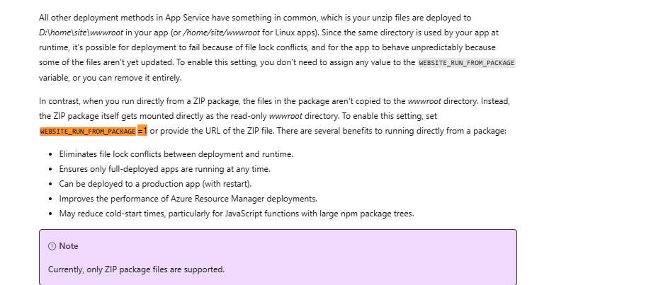

    4. In your App Service Configuration > Application settings, add:
      • SCM_DO_BUILD_DURING_DEPLOYMENT = false
      • WEBSITE_RUN_FROM_PACKAGE = 1 (recommended for better performance)

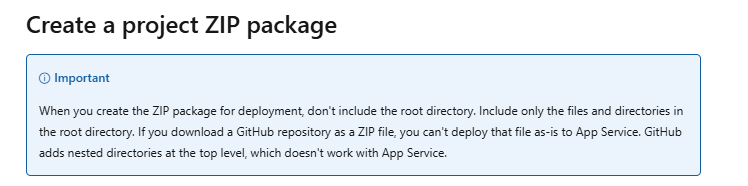

    2. Create a valid ZIP package for App Service
      • From the root of the built app (the folder that contains the entry file such as index.js or the built web assets), create a ZIP without nesting an extra top-level folder.
      • For example:
             zip -r app.zip .
      • Ensure that the ZIP structure matches what App Service expects: the entry point and package.json (if needed) are at the root of the ZIP, not inside additional nested directories.
