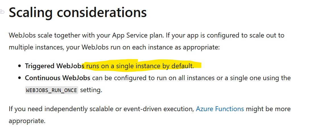

By default, Triggered WebJobs (including scheduled ones) have is_singleton set to false. This means:
  • The job always runs on one App Service instance (Azure selects it automatically).
  • If a new trigger fires while the previous run is still executing, a second instance of the job can start in parallel on the same App Service instance.

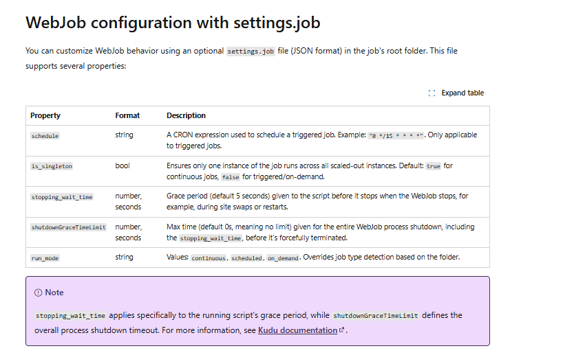

Add or update a settings.job file in the root of your WebJob folder with the following content:
  "schedule": "0 */5 * * * *",
  "is_singleton": true
After adding this and redeploying the WebJob, runs will be serialized — the (n+1)th execution will wait for the nth one to complete.
This is usually the safer option for scheduled jobs to avoid race conditions or duplicate processing.

      • For continuous WebJobs, is_singleton defaults to true, which means only one instance of that WebJob runs across all scaled-out App Service instances.
      • For triggered WebJobs, is_singleton defaults to false; they run on a single App Service instance by design, but multiple runs of the same job can overlap unless you explicitly enforce singleton behavior.
    2. Controlling singleton behavior with settings.job The settings.job file lets you control concurrency and behavior:
           "is_singleton": true,
           "run_mode": "scheduled"  // or "on_demand" / "continuous" as needed
      • is_singleton: true ensures only one instance of the job runs across all scaled-out instances.
      • For a triggered job that runs every 5 minutes, if is_singleton is true and a new trigger fires while a previous run is still executing:
        • The (n+1)th run will not start until the nth run has finished. The job is effectively serialized.
