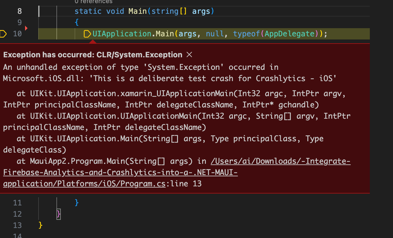

I’m sorry that I haven’t been able to resolve your issue in this case. Over the past few days, I’ve been investigating and setting up a separate environment integrated with Firebase to better understand the behavior, and I encountered a similar issue as yours.
From my experience, integrations with Firebase on iOS require extra caution, as I also frequently run into issues when working with Firebase.

    Since the issue only occurs on iOS and not Android, and given that you've already tried multiple approaches without success, I'd like to suggest creating a blank MAUI project and running on ios emulator to help us narrow down whether the root cause is coming from your project configuration/packages or from the iOS environment/SDK setup itself.
    Please let us know the result so we can proceed with the next steps accordingly.
