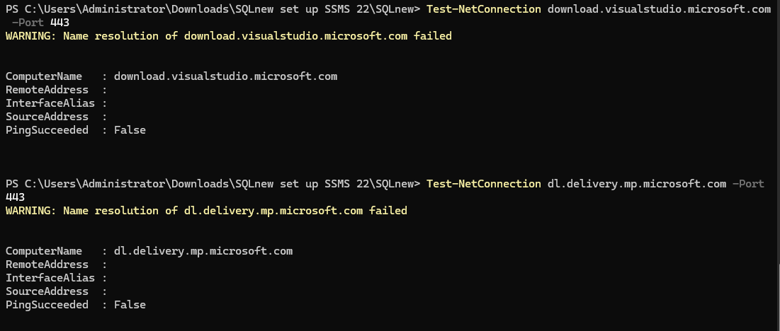

Hi,
When doing the setup of SQL Server Management studio installer 22 on Windows server 2025, I got "internet connection, and not able to do the download". How to find out the issues on the server for this?

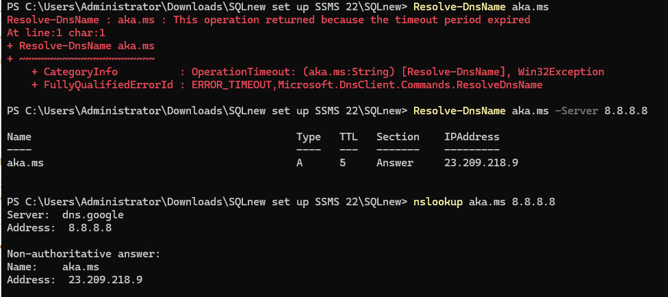

Deepesh Dhake 80 Reputation points
2026-06-02T16:15:41.7966667+00:00
It looks like problem is DNS, not connectivity or firewall. You can try following in order.
  1. See what DNS actually does with the name:
Resolve-DnsName aka.ms
nslookup aka.ms

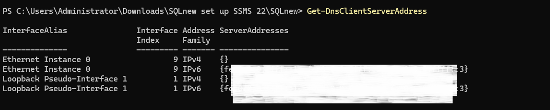

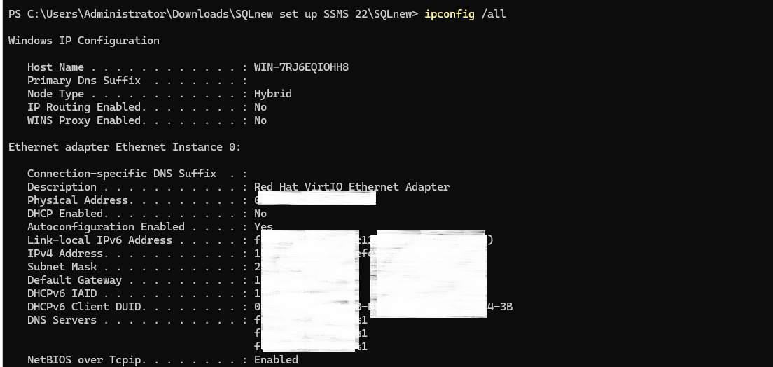

  1. Check which DNS servers the box is using:
Get-DnsClientServerAddress
ipconfig /all
Look at the configured DNS server entries. If they're empty, pointing at a dead internal resolver, or pointing at something that only serves internal zones, that's your failure.
  1. Test against a known-good public resolver to isolate the fault:
Resolve-DnsName aka.ms -Server 8.8.8.8
nslookup aka.ms 8.8.8.8
If 8.8.8.8 resolves it fine but your configured DNS doesn't, the problem is your DNS server / network config, not the host or the internet.
  1. Check the hosts file for stray entries (this explains the earlier bogus-IP behavior):
C:\Windows\System32\drivers\etc\hosts

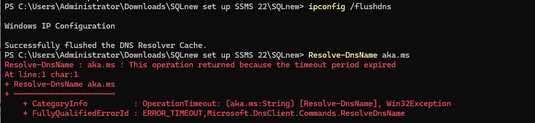

  1. Flush and retry:
ipconfig /flushdns

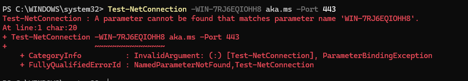

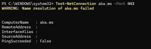

  1. Deepesh Dhake 80 Reputation points
    2026-06-01T19:24:55.0866667+00:00
    You can try following check:
    1. Test basic connectivity like "ping" test
    2. Check proxy settings like "netsh winhttp show proxy".
    3. Test HTTPS outbound like "Test-NetConnection -ComputerName aka.ms -Port 443"
    Most likely causes:
    • Outbound port 443 blocked by firewall
    • Proxy required but not configured
    • Group Policy restricting internet access
