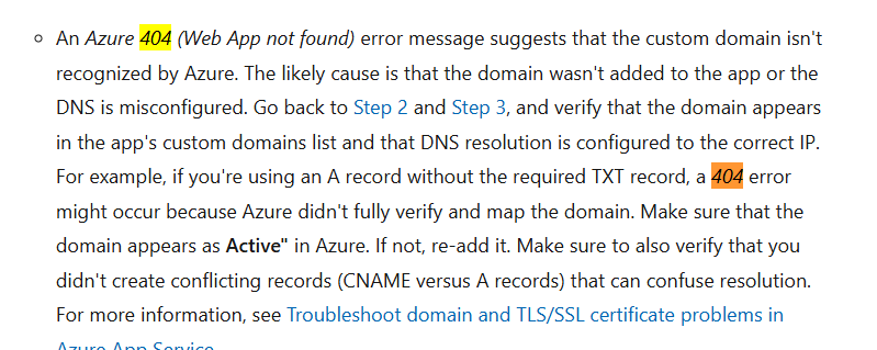

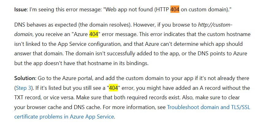

    Hi @Bullseye Dev Thanks for the detailed update and screenshots in PVT chat
    This matches a known behavior with Azure Static Web Apps: intermittent 404s on the custom domain only (while the default *.azurestaticapps.net works) usually points to edge routing/propagation issues — especially when a domain is reused after being bound to another SWA in a different subscription.
    Azure’s global edge network can retain stale mappings for a while, causing random asset-level 404s until everything converges.
    Recommended next steps:
    • Wait 24–48 hours from your last domain change (avoid frequent add/remove cycles).
    • Double-check DNS:
      • www >CNAME to your SWA hostname
      • Root domain >properly configured ALIAS/A record
    • Test using the default Azure URL to confirm the app itself is healthy.
    • Clear browser cache (Incognito) + flush local DNS.
    REference :
    https://learn.microsoft.com/en-us/azure/static-web-apps/custom-domain
    https://learn.microsoft.com/en-us/azure/static-web-apps/custom-domain-external
    https://learn.microsoft.com/en-us/troubleshoot/azure/app-service/connection-issues-with-ssl-or-tls/troubleshoot-custom-domain-issues-azure-app-service
    If the issue persists after 48 hours, please let us know
