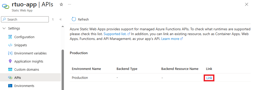

    4. Once the redeployment completes, go back to your RTUO-App in the Azure Portal:
      • Navigate to APIs in the left menu.
      • In the Production environment, click Link.
      • Set Backend resource type to Web App.
      • Select your subscription, resource group (RTUOLLC), and Resource name: rtuo-backend-linux.
      • Click Link.
    After linking, all requests to /api/* on your Static Web App will be automatically proxied to rtuo-backend-linux.azurewebsites.net.

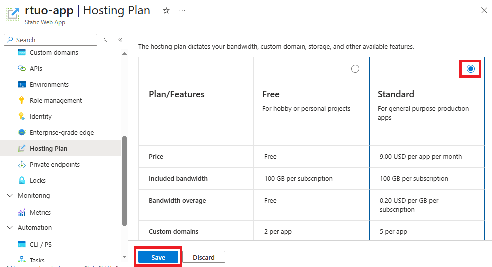

    This approach works on the Standard plan (bring-your-own backends are not supported on Free).

    Navigate to your static web app in portal, on left, click on Settings -- Hosting Plan. Select Standard and click Save.
    Click on Settings -- APIs. Click on Link next to Production.

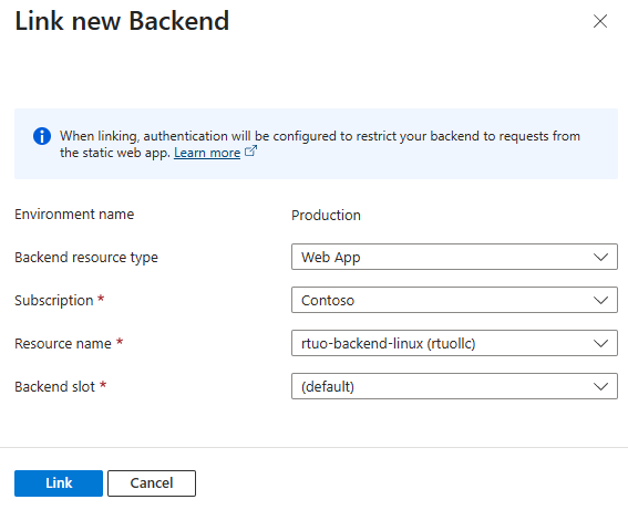

    Select Web App, select your Subscription, select rtuo-backend-linux, select slot, click Link, similar to below screenshot:
    Please click Accept Answer if the above was useful.

    2026-04-29T17:31:56.02+00:00
    To link RTUO-App (a Static Web App) to rtuo-backend-linux (an App Service Web App) and handle the managed backend situation, follow these supported behaviors.
    1. In Azure Portal, open the RTUO-App Static Web App.
    2. In the left menu, select APIs.
    3. In the Production environment row, select Link (or Configure linked backend if available).
    4. In Backend resource type, select Web App.
    5. In Subscription, choose the subscription that contains rtuo-backend-linux.
    6. In Resource name, select the rtuo-backend-linux App Service.
    7. Select Link.
    After linking, any request from RTUO-App to paths beginning with /api is proxied to rtuo-backend-linux. The backend App Service must expose its API under the /api path (for example, https://rtuo-backend-linux.azurewebsites.net/api/...).
    When the link is created, Azure configures an identity provider named Azure Static Web Apps (Linked) on rtuo-backend-linux so that only traffic proxied through RTUO-App is allowed, unless the authentication configuration is changed.
    If the portal only shows a managed backend and does not offer the option to select a Web App:
    • Linked backends are only available for Static Web Apps on the Standard plan or above. If RTUO-App is on a lower plan, the UI will not allow selecting an external Web App backend.
    • To use rtuo-backend-linux as a custom backend, RTUO-App must be on a supported plan where Configure linked backend is available and allows choosing an App Service Plan–based Web App.
    • If RTUO-App is already on a Standard (or higher) plan and the Backend resource type picker still does not show Web App, this indicates a portal/feature limitation for that resource and requires Azure support to adjust or confirm the backend configuration.
