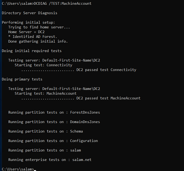

    • Check userAccountControl attribute: The computer account for DC2 must have the SERVER_TRUST_ACCOUNT and TRUSTED_FOR_DELEGATION flags. If these are missing, DC2 cannot replicate.
      • Run DCDIAG /TEST:MachineAccount on DC2 and check for errors.

      • Use DCDIAG /TEST:MachineAccount and correct any issues with the computer account for DC2.
      • If needed, reset the machine account password using netdom resetpwd.
